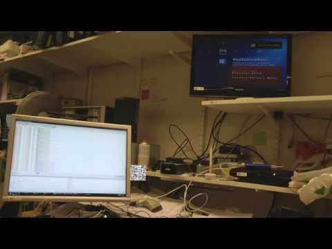

    Use Beagle Data Center Software to read the dumps.
    http://www.totalphase.com/support/pr...beagle_usb480/
    One file is a ps3key boot, the other is a psdowngrade boot.
    The psdowngrade is supposed to be encrypted and not "analyzeable" according to a distributor. But maybe something can be learned anyway.
    Have fun!
    test boot ps3key.tdc
    service mode by psdowngrade.tdc
